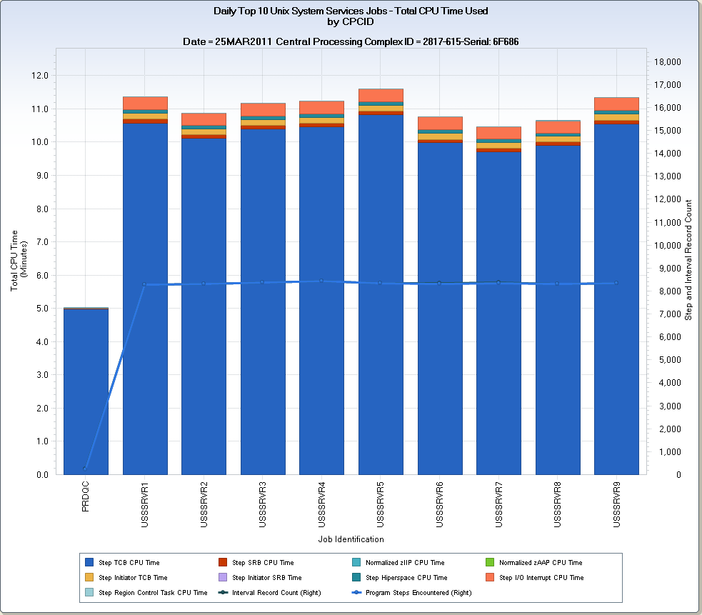

For CPU, the CPU time used by each of the top ten USS jobs is displayed using a vertical bar. The bar is segmented by CPU time type (for example, TCB, SRB, I/O Interrupt, zIIP, zAAP, and so on). Two horizontal lines show the program count (number of unique program executions) and interval count (number of interval records) encountered for the USS job. For short running steps, the interval count and program count values have similar values. For long running programs, the interval count exceeds the program count.

The example shows the CPC level chart generated for USS jobs executing on an IBM z/196 2817-615 CPC. The nine largest users of CPU time are the USSSRVRx jobs, which all have similar CPU consumption characteristics. The chart shows that for the day depicted, each of these USS jobs used about 11 minutes of CPU time. Most of this time was TCB time. These USS jobs appear to be frequently executed (about 8500 times each). The interval count and program count values are identical, meaning that they represent quick running, one-step USS job executions.
