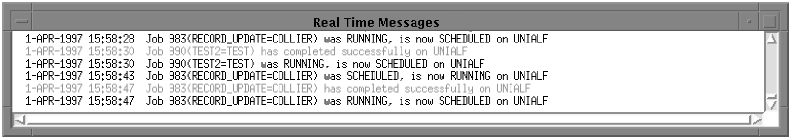

Job Management Manager Real Time Message Display Window
The Real Time Messages Display window displays all Job Management Manager job events on the system as they occur during your Job Management Manager session. This window maintains up to 100 lines of messages; you can use the scroll bar to see messages that have scrolled off the top of the window. Messages from previous sessions are stored in a log file with NSCHED$:DATA:VERMONT_CREAMERY.LOG as a default name. You need SYSPRV right to view this log file.
Some messages are highlighted, while others are displayed in normal print.
These messages
Provide information about ...
Highlighted
Your jobs that have currently completed, all jobs that were modified, all jobs with control action that were requested
Normal
All other messages
On a color display, different types of messages can appear in different colors, as determined by the file SCHEDULER$MOTIF.DAT in the DECW$SYSTEM_DEFAULTS directory or your DECW$USER_DEFAULTS directory.
