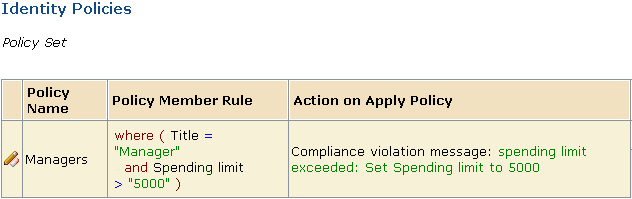

The following figure shows the sample compliance policy described in this example.
