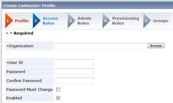

Using the Wizard tab controller, you can configure a task as a wizard. In this tab configuration, administrators use each tab in a specified order. When administrators complete one tab, they click the Next button to move to the next tab in the list. A display at the top of the wizard indicates the progress, and allows that administrator to return to previously visited screens.
The following example shows a custom task, Create Contractor, displayed as a wizard.
