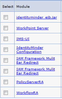

- Click iam_im on the page that appears.
- Under Modules, click Manage Modules.
- Click PolicyServerRA in the list of modules.
- Under Additional Properties, click Resource Adapter.
- Under Additional Properties, click J2C connection factories.

- Follow these steps to create the Workflow connector object:
- Return to the Manage Modules page.
To go to that page, repeat steps 1 through 5 or click Manage Modules in the breadcrumbs.
- Click WorkflowRA.
