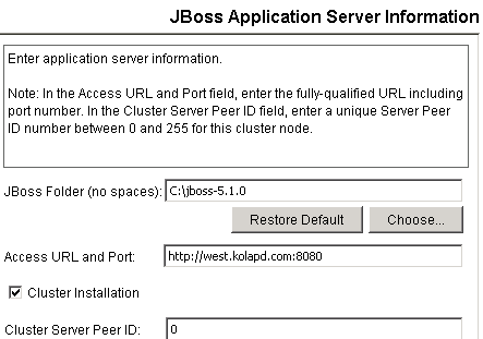

  6. Complete the JBoss Application Server Information page as follows:
    1. Enter the Access Server URL and port with the URL and port number of the web server used for load balancing.
    2. Select Cluster Installation.
    3. Enter a Peer ID, a unique number between 0 and 255. Make a record of the Peer ID, so that you use a different number for other nodes.
    jboss_details
