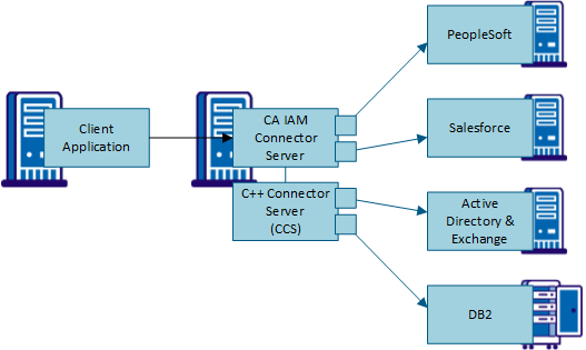

Client applications can use a connector server to get data from the endpoints. Some client applications also manage some data on the endpoint. A connector server uses a connector to manage each endpoint.
When you install CA IAM CS, you have the option to install CCS in a managed mode. If you do this, CA IAM CS manages CCS and the C++ connectors that it manages.
If you prefer to install CCS on its own, it manages the C++ connectors directly.
You cannot use both CA IAM CS and CCS to manage the same endpoint type
Example: Two kinds of connectors
In this example, CA IAM CS serves the connectors for PeopleSoft and SalesForce. CCS serves the connectors for Active Directory and DB2.
