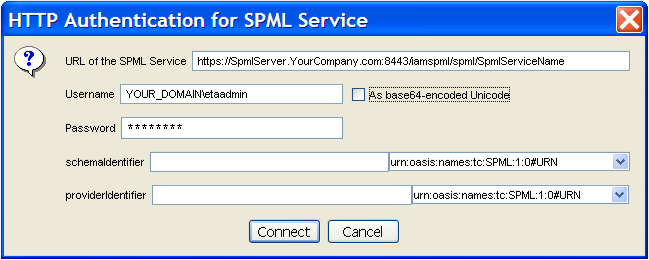

- Using the SPML Manager, connect to an SPML service.
