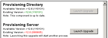

- Run the CA Identity Manager installer from the CA Identity Manager media.
The Upgrade Wizard starts.
- In the Upgrade Wizard, next to Provisioning Server, click Launch Upgrade.
The Provisioning Server upgrade starts. Note the following:

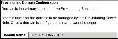

- Complete the Provisioning Domain screens.
Note: You may notice a slight delay when you click Next on the first Provisioning Domain screen.
- Enter a password for the domain.
