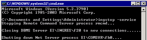

- Stop Ingres with the following command:
ingstop -service
- If you get an error, use this command:
ingstop -kill

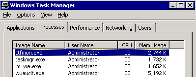

- Verify that all of the following Ingres processes are stopped (use the Window Task Manager or the UNIX ps command):
- dmfacp.exe
- dmfrcp.exe
- iidbms.exe
- iigcc.exe
- iigcn.exe
- iijdbc.exe
- iistar.exe

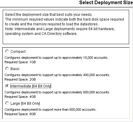

- Answer the question about deployment size if the Select Deployment Size screen appears in your upgrade. Consider the following guidelines, while allowing room for future growth:
- Compact—up to 10,000 accounts
- Basic—up to 400,000 accounts
- Intermediate (64 bit only)—up to 600,000 accounts
- Large (64 bit only)—more than 600,000 accounts
Note: If you are installing a Provisioning Directory in an established CA Identity Manager installation, be sure to make the deployment size large enough. Otherwise, an error occurs because the data does not fit when loaded into the data files. Intermediate and Large installations require 64-bit Directory installs (either Solaris or Windows 64 bit).

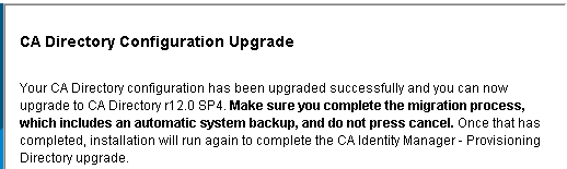

- If you are upgrading a pre-r12.5 installation, a CA Directory Upgrade Configuration appears:
- Click Finish to perform the CA Directory upgrade. Note the following:
- The CA Directory starts by backing up your current installation when you click Migrate.
- Select a Typical installation type when prompted during the CA Directory upgrade.
- Due to architectural changes effective in CA Directory r12 SP1 and higher, reporting databases and unnecessary DSAs are removed before the CA Directory upgrade.

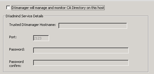

- During CA Directory installation, you are asked for information about installing DXadmind for DXManager, however, you can safely uncheck this option. The Provisioning Directory does not use DXManager.
Once the CA Directory upgrade completes, the Provisioning Directory upgrade resumes.
