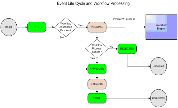

In CA Identity Manager, a workflow process is associated with an event, an action that occurs during task processing. When an event enters the Pending state in its lifecycle, CA Identity Manager invokes any associated workflow process and pauses the event execution until the process completes. CA Identity Manager then performs or rejects the event based on the results of the workflow process.
This sequence is shown in the following diagram:
