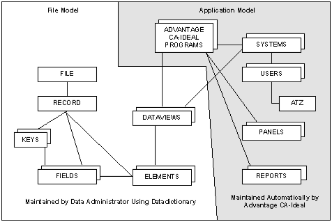

The following graphic illustrates the entity types and relationships in the dictionary and their relationship to CA Ideal. In this graphic, the unshaded area represents the file model, and the shaded area represents the application model.
Notice that the file model for a sequential file is different from the model for an CA Datacom/DB table. The AREA and TABLE are replaced by a FILE and a RECORD and no DATABASE is specified.
