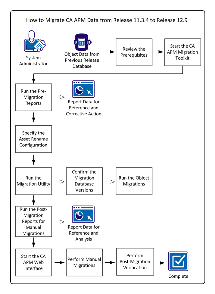

The following diagram illustrates how a system administrator migrates data.
This diagram shows the process for migrating CA Asset Portfolio Management data from Release 11.3.4 to 12.9.
To migrate CA APM data, perform these steps:
  1. Review the Prerequisites.
  2. Start the CA APM Migration Toolkit.
  3. Run the Pre-Migration Reports.
    Use the pre-migration report data for reference and corrective action.
  4. Specify the Asset Rename Configuration.
  5. Run the Migration Utility.
    1. Confirm the Migration Database Versions.
    2. Run the Object Migrations.
  6. Run the Post-Migration Reports for Manual Migrations.
    Use the post-migration report data for reference and analysis.
  7. Start the CA APM Web Interface.
  8. Perform Manual Migrations.
  9. Perform Post-Migration Verification.
