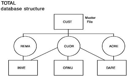

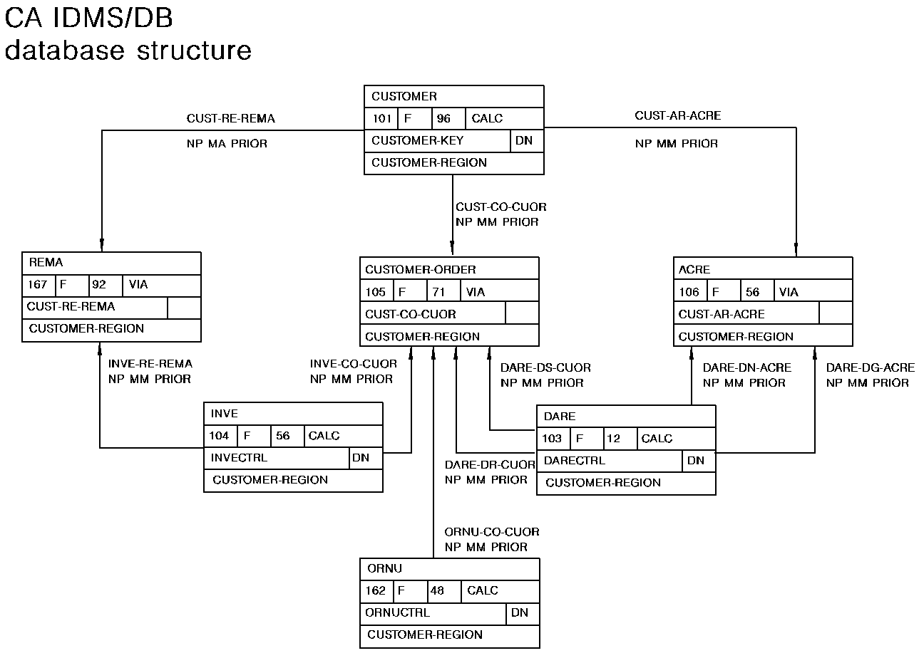

Equivalent Total and CA IDMS/DB Data Structures
The following diagrams are of a sample Total database and the corresponding CA IDMS/DB database. Note that the CUSTOMER and CUSTOMER-ORDER CA IDMS/DB records correspond to the Total master file CUST and the CUOR variable file. Synonyms are provided to take advantage of the longer names permitted under CA IDMS/DB.
