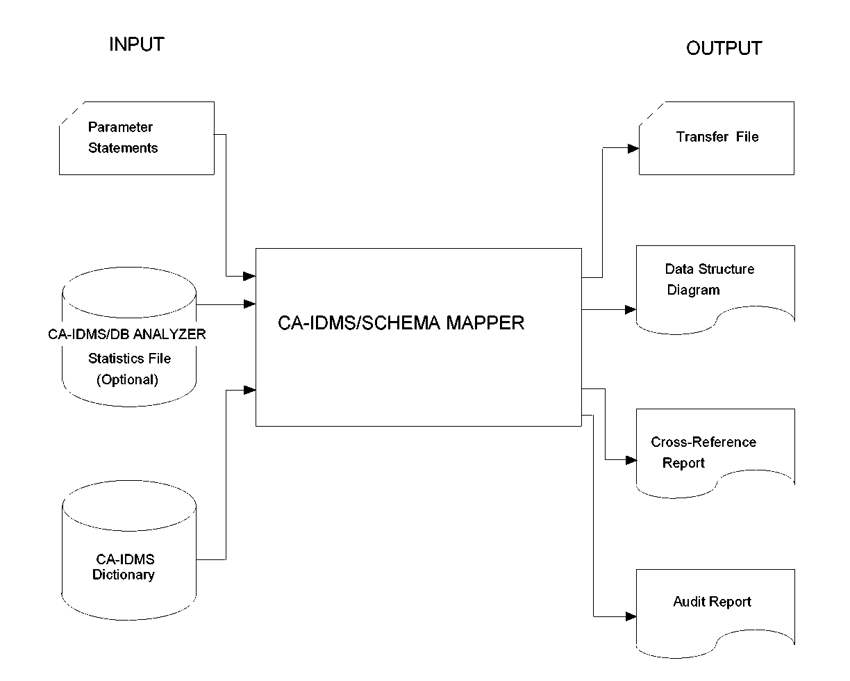

CA IDMS Schema Mapper reads the definition of the schema or subschema you want to represent from the CA IDMS dictionary.
Exhibit 1.1: CA IDMS Schema Mapper Process
