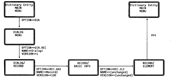

The exhibit below shows a typical sequence of screens accessed by combination codes to answer the same question that was asked for Option Defaults.
The query:
- What is the description of a record in the dialog Dialog1 (version 1) and what are the elements in that record?
- The spelling and the version number of the record are verified by accessing the Dialog/Record cross-reference screen first.
Exhibit 3.13: Typical Sequence of Events Using Combination Codes
