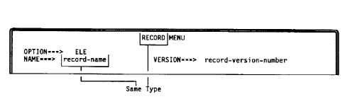

Accessing an Information Screen
To access a detail or cross-reference information screen from a second level menu, type:
Press Enter. The RECORD/ELEMENTS cross-reference screen displays.
The following display shows an alphabetical list of the dictionary entities, with their codes in the left column. The options on each second level menu are also listed under Valid Choices in the exhibit.
