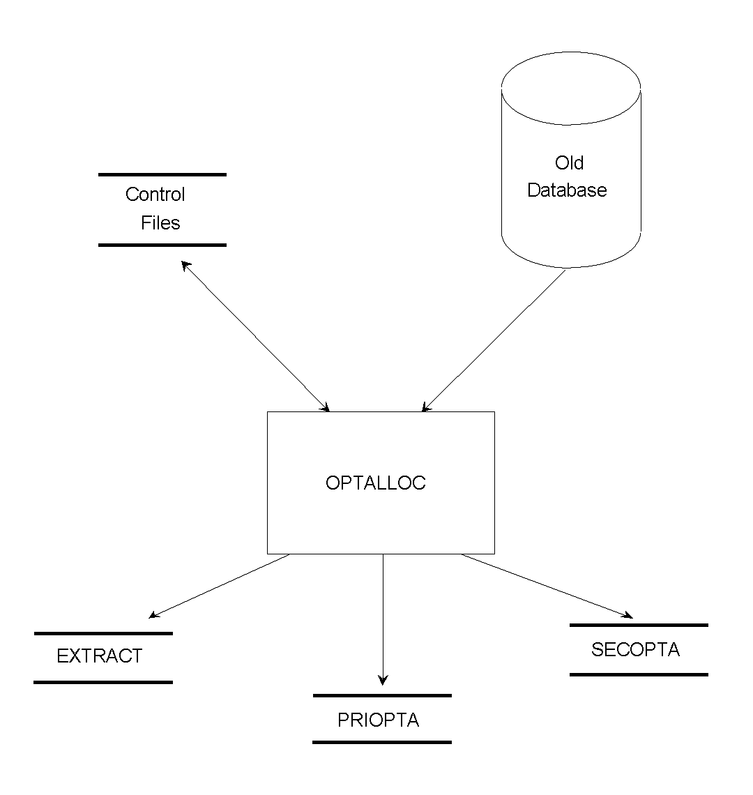

Work File Usage For OPTALLOC Step:
Estimating Space for Work Files (EXTRACT, PRIOPTA,SECOPTA):
