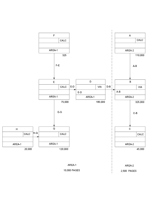

Refer to Figure 5.1 for an example. If you were to audit USERSETS only in AREA-1 (AREA-2 is NOSWEEP), you would estimate the number of I/Os as follows:
  10,000 pages swept
+ 75,000 type E records for set F-E
+ 120,000 type G records for set E-G
+ 120,000 type G records for set H-G
+ 185,000 type D-B set occurrences
= 510,000 I/Os
(v=1, because all B records are in AREA-2.)
If record type G were stored VIA set E-G, it would take approximately 120,000 fewer I/Os to audit the database for a total of 390,000 I/Os. If, in addition, record type E were stored VIA set F-E, it would take approximately 75,000 fewer I/Os to audit the database for a total of 315,000 I/Os.
Figure 5.1: AREA-1 and AREA-2, Estimating USERSETS I/Os
