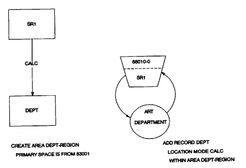

4. A CALC record is connected to the CALC set on an incorrect page
Every page of an area contains a system record (SR1) that is the owner of all CALC records whose keys randomize to that page. The CALC set is the only set for which CA IDMS/DB Audit can determine the accuracy of the set owner by invoking the IDMSCALC (or IDMSCLCX) routine for each CALC record. CA IDMS/DB Audit ensures that each CALC record is connected to the correct CALC set. (If a CALC record is not connected to the correct CALC set, it cannot be located by an OBTAIN CALC command.) In Figure 2.17, ART DEPARTMENT is an example of a CALC record connected to the CALC set on an incorrect page. CA IDMS/DB Audit corrects this so that ART DEPARTMENT is connected to the CALC set on page 88,004.
Figure 2.17: CALC Record Connected to an Incorrect CALC Set
