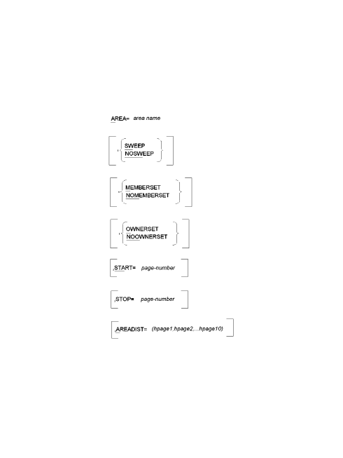

In the EXPLICIT Mode, the AREA statement is used to include an area, or a portion of an area, in processing. (CA IDMS/DB Analyzer will also sweep an area if the owner of a set specified in a SET statement resides in the area.) The AREA statement is meaningful only if you selected either ACCUMULATE or ALL in the PROCESS statement.
Exhibit 3.11: AREA Statement Syntax
