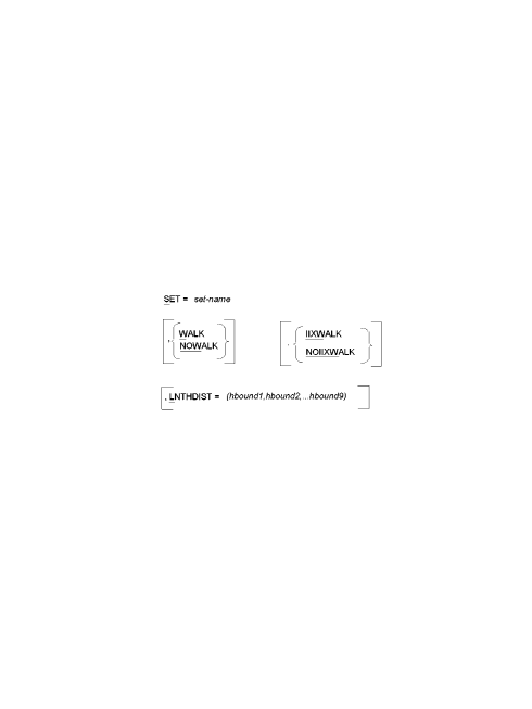

SET Statement
In the AUTOMATIC Mode, a SET statement is used to exclude or to modify the accumulation of statistics for a specific set type. Use this statement for SR8 (integrated index) sets.
To use the SET statement, you must select either the ACCUMULATE option or the ALL option of the PROCESS statement.
Exhibits 3.10a-c, at the end of the AUTOMATIC Mode subsection, show which set statistics are collected with each parameter combination.
Exhibit 3.8: SET Statement Syntax
