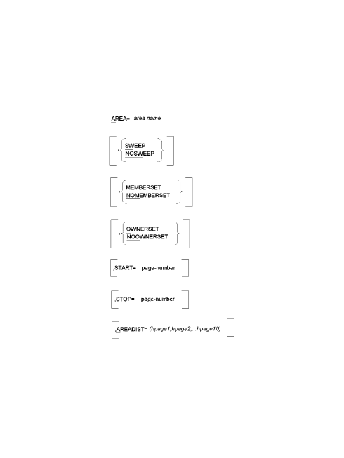

Exhibit 3.6: AREA Statement Syntax
AREA Parameter
AREA=area-name
In the AUTOMATIC Mode, AREA identifies an area that you want to exclude or limit. The area you specify must be one that is defined by the subschema you are using to process the database.
Default Parameters
You do not have to specify default parameters such as SWEEP, MEMBERSET, and OWNERSET. They may, however, be coded for documentation purposes.
