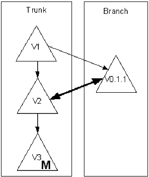

The following diagram shows a two-way merge process. The bold bi-directional arrow shows the comparison between the branch and trunk versions.

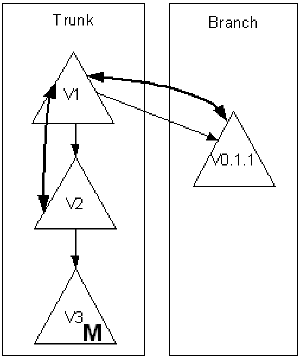

The following diagram shows a three-way merge process. The curved arrow shows the comparison between the branch and trunk versions, and the comparison between the common ancestor and the trunk and branch versions.
