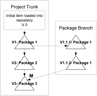

In the following diagram, the branch version 1.1.2 is concurrently merged with the project trunk. The version created by the concurrent merge becomes the latest on the view's trunk, version 3, and is tagged as merged.
In the preceding diagram, if version 2 did not exist on the project trunk, the concurrent merge process would have created a non-tagged version 2. Merged tags appear only when changes have been made on the trunk that could conflict with changes made on the branch. If version 1 is the latest version when the merge executes, no changes exist on the trunk to conflict with the branch versions, so a merged tag is unnecessary.
