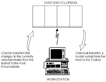

Communications Between the Toolset and the Host Encyclopedia
Check in and check out functions transfer models between the Toolset and the Host Encyclopedia. The following example of automatic check in and check out shows:
- Check in and check out begin at the Toolset with CA Gen commands
- The communication occurs through TSO.
