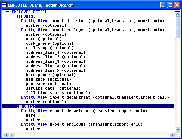

To demonstrate the use of custom interfaces, the following illustration shows the Action Diagram of the Employee Detail Procedure Step from the sample model with both the Import Views and Export Views expanded:
Action Diagram
You can customize one or more interfaces using the import and export views as defined in the preceding procedure step.

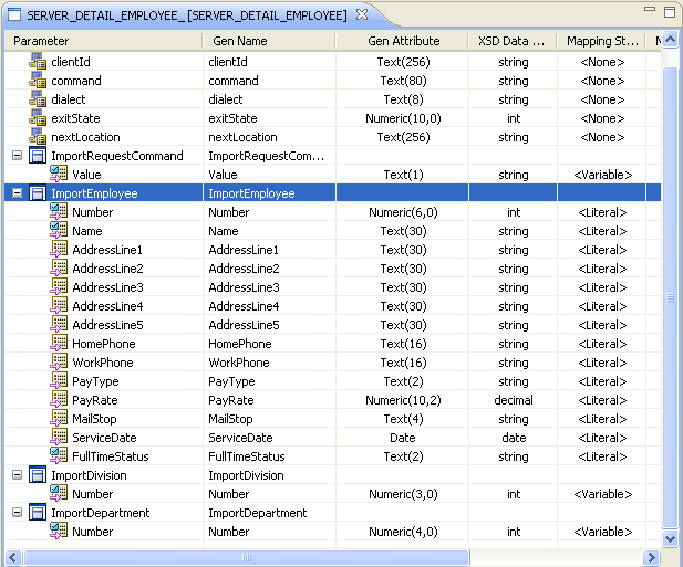

    The Editor view opens and displays the parameters of the import and export views as defined by its associated procedure step. If you double-click more than one interface, each interface displays on a different tab in the Editor view.
    PStep Interface Designer Editor
  4. Change the values, as needed, for those parameters that are associated with the newly created custom interface using the Input Mapping tab and the Output Mapping tab:

    To change the mapping style of all the parameters in an entity or group view simultaneously, you can select the mapping style cell for the entity or group view.
    Example:
    To change the Mapping Style of the ImportEmployee parameter, select the Mapping Style from the drop-down and press the Enter key.
    Group view change
    The Mapping Style for the parameter is changed.
