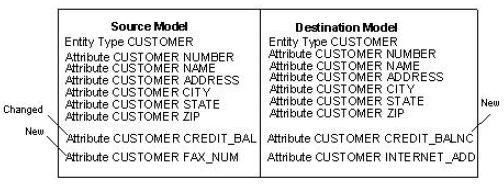

Consider two models used for parallel development, where the goal is to keep them synchronized. The current status is one of the following:
The following report is a sample view of the data displayed in each of the sections as evaluated by the Compare Report process:

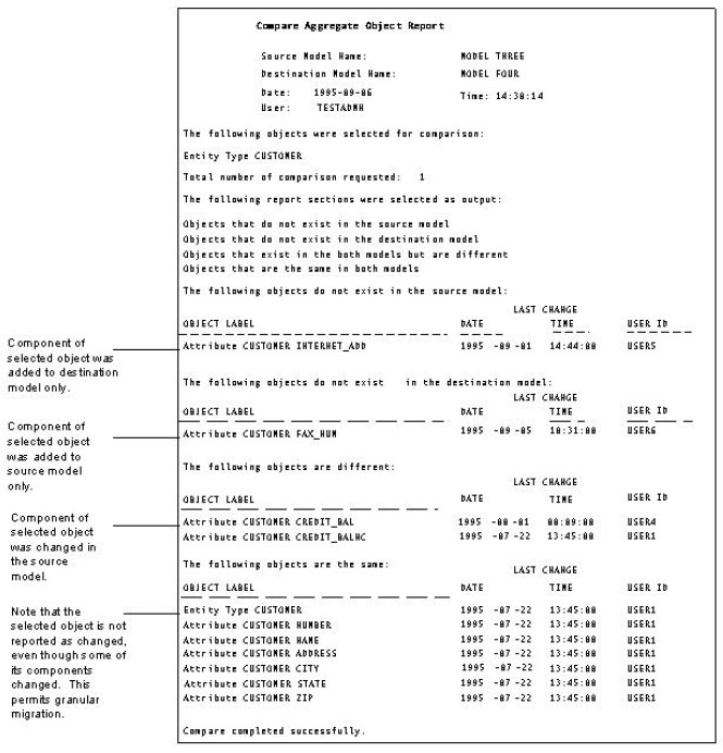

When you report on a single high-level aggregate object, here the Entity Type, CUSTOMER, the Compare Report process reports on not only the selected object, but also on its subordinate aggregate objects. The following is sample Compare Report on an Aggregate and Its Subordinate Objects:
