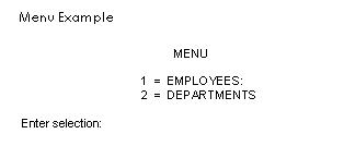

You can also map views to ensure that the correct data flows. The figure that follows is an example of a basic menu.
Menu Example
