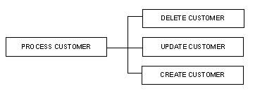

This diagram shows a Horizontal Structure Chart:

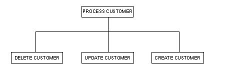

This is a Vertical Structure Chart:
