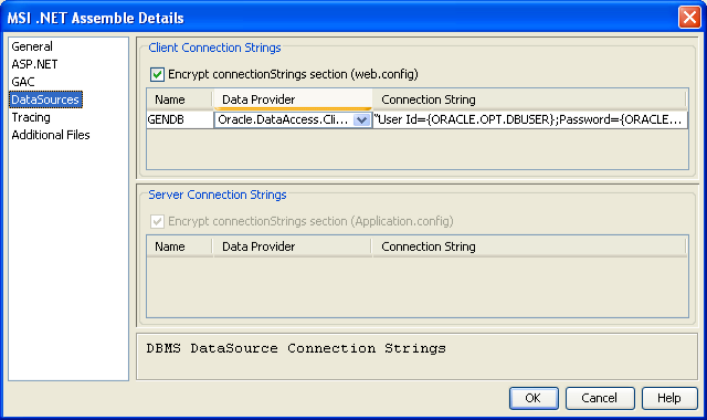

With the DataSources node on MSI .NET Assemble Details dialog in the Build Tool, you can enable the encryption of the following sections of the configuration files:
The following screenshot details the DataSources node on MSI .NET Assemble Details dialog:
MSI.NET Assemble Details dialog with DataSources selected
