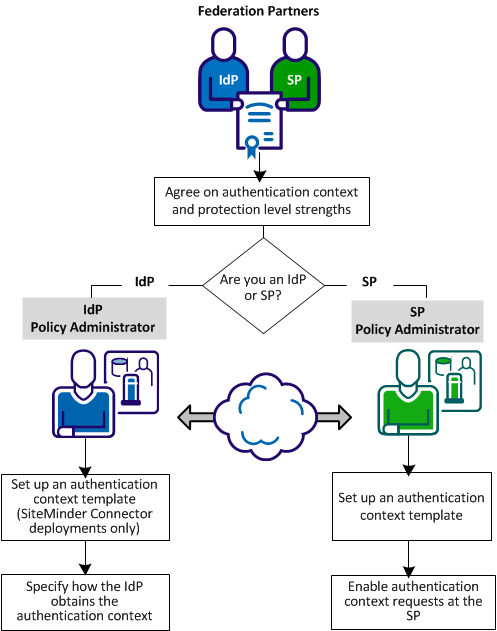

The following figure shows the configuration process for each partner. Federation Manager does not have to be installed at each site.
Process for configuring authentication context
Complete the following steps to configure authentication context processing:
  1. Agree on authentication context and protection level strengths.
  2. Set up an authentication context template.
  3. Complete the task for your site:
