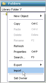

    2. Click Folders in the left pane, and at the root folder, click Import.
    Select Import from the Folders tab under Library Browser.

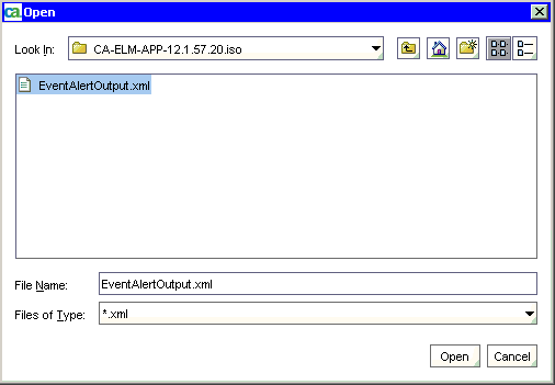

    1. Select the sample IT PAM process, EventAlertOutput.xml, from the extracted iso image and click Open.
    Open EventAlertOutput.xml

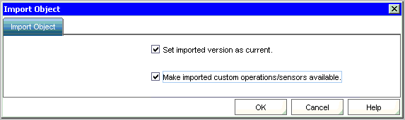

    1. Select both options on the Import Object dialog and click OK.
      Select both Set imported version as current and Make Imported custom operations/sensors available.
