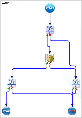

    A model similar to the following appears. This example model contains minimal requirements for CA Enterprise Log Manager.
    Content of EventAlertOutput

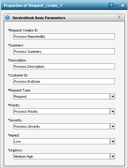

  2. Notice how the ServiceDesk Basic Parameters meet CA Enterprise Log Manager requirements.
    1. Double click the Request_Create_1 icon.
    Image of Request_Create_1 icon.
    The Request_Create operator passes the data returned by the action alert query to your target product (application). A similar operator is required for any process that is to be run from CA Enterprise Log Manager.
    1. Under ServiceDesk Basic Parameters, notice that local process parameters are specified with the following syntax:
      BasicParameter = Process.LocalParameter
      Note: Local process parameters are the Event/Alert Output Process Parameters you add to CA Enterprise Log Manager when you configure CA IT PAM.
    EventAlertOutput Process Parameters are entered when you configure IT PAM in CA Enterprise Log Manager.
    1. Since the target application is the CA Service Desk product, the following local process parameters are defined as described on the following table:

The following example shows valid local parameters for ServiceDesk Basic Parameters. The entries are case-sensitive. That is, Process.ReportedBy must be entered exactly as shown with a capital "R" and a capital "B" for example.
Properties of Request_Create.

  2. Notice that for CA Service Desk, an adjustment is needed to ensure that the values of severity and priority that are entered in CA Enterprise Log Manager are correctly interpreted by CA Service Desk.
    1. A pre-calculation operator appears after Start and before the Create_Process operator. In the following example, it is named Fix_Sev_Pri.
    Define a precalculation operator: Fix_Sev_Pri--SCR

  3. Notice that the following return value, or output interface, parameters are formatted as required by CA Enterprise Log Manager:
  4. View the calculation operator for request creation success. This format must be used in any event/alert output process to be run from CA Enterprise Log Manager.
    1. Click the icon for the calculation operator for request creation success.
    2. Select the Calculate tab and click ... in the source code field.
    3. Notice how the success calculation operator is defined in the source code:
      Process.ResultString = "Request " + Request_Create_1.newRequestNumber + " created in CA Service Desk.";
  5. View the calculation operator for failure. This format is required for any event/alert output process to be run from CA Enterprise Log Manager.
    1. Click the icon for the calculation operator for failure.
    3. Notice how the failure calculation operator is defined in the source code, where the Process.FaultString maps to the appropriate SOAP variable:
      Process.FaultString = Request_Create_1.SoapErrorResponse;
