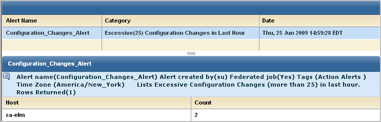

Track the Alert Job Progress
You can view results returned by the queries selected for the alert you created. The results displayed for the example Configuration_Changes_Alert are displayed in CA Enterprise Log Manager under the headings Host and Count.
  1. Select the Alert Management tab, and the Action Alert subtab.
  2. Click the name of the alert that you scheduled.
  3. View the results for that alert.
    Example results follow:
    Click the alert to view the results at the bottom of the page.
