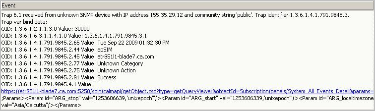

An unrelated example of how an SNMP trap sent by a CA Enterprise Log Manager alert appears in CA Spectrum OneClick follows. The link is the URL you can paste in a browser to display the CA Enterprise Log Manager table with details presented in CEG format.
This screenshot depicts the format of a trap received by CA Spectrum from a CA Enterprise Log Manager alert.
