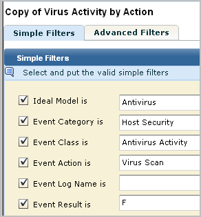

Query for Antivirus Scan Failure
  1. Copy Virus Activity by Action
    This query filters for all Antivirus host security actions.
  2. Use the following definition as a guide:
Category
Class
Action
Result
Security Level
Host Security
Antivirus Activity
Scan Error
Success
6
  1. Define the simple filter as follows:
    Success of Scan Error is similar to virus Scan failure.
  2. Save as Alert: Virus Scan Failed
