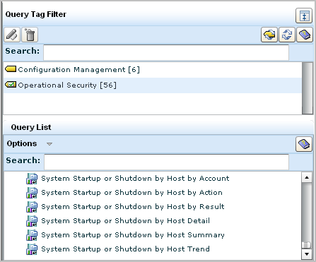

  1. Click the Queries and Reports tab.
  2. Select a query tag filter that matches the Category of a severe event.
    For example, select Operational Security.
  3. Review the query list for queries with names containing keywords found in the Class or Action for the identified event type.
    For example, the keywords System Shutdown appear in queries beginning with the phrase System Startup or Shutdown by Host.
    Select Configuration Management and view queries on the list that begin with System Startup or Shutdown.
  4. Copy the query System Startup or Shutdown by Host Detail. Highlight the query and select Copy from the Options drop-down list.

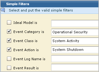

  5. Click Query Filters and compare the default with the table entries for the severe event type.
    For this query, only Operational Security is selected.
  6. Refer to the table for values to enter for Class and Action.
    For example, select System Activity for the Class and System Shutdown for the action.
    Add Event Class is System Activity and Event Action is System Shutdown.

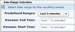

  10. Click Result Conditions. For severe conditions, consider querying frequently.
    For example, select the predefined range for the last 5 minutes to run the query every 5 minutes for the occurrence of this severe event.
    Select Last 5 minutes from the Predefined Ranges drop-down list.
