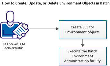

How to Administer Environment Definitions in Batch
Complete these steps:
  1. Create SCL for Environment definitions.
  2. Execute the Batch Environment Administration facility.
