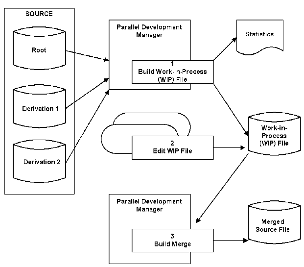

The following diagram provides a simple illustration of how PDM operates:
This figure illustrates how PDM works.
In Step 1, the Work-in-Process (WIP) file is created and statistics are reported. In Step 2, the WIP file is edited. In Step 3, the merged member is built.

The first step in using the Parallel Development Manager is to build a Work-in-Process (WIP) file. The WIP file is a PDS structure which combines three source files: the Root, Derivation 1, and Derivation 2. As an example, if PDM is being used to manage a vendor update, the Root would be the source for the old release, Derivation 1 would be the source for the in-house modifications made to that old release, and Derivation 2 would be the source for the vendor's new release.
As the source input files are being compared to produce a WIP File, statistics are generated. These statistics reveal critical information about the source comparison, such as the number of inserts and deletes per module, the percentage of the module that has changed, and the number of simultaneous (and potentially conflicting) updates.
Editing the WIP File
With statistics in hand, it is now possible to view and edit the members which contain conflicts. At this point, you can decide which conflicts to resolve and how to resolve them.
Creating Merged Source
Once you have viewed and edited the WIP file to your satisfaction, you can use PDM to automatically merge the WIP source into an output source library. This output source is then ready for compilation or, if applicable, introduction into CA Endevor SCM. The Parallel Development Manager can be used in both online and batch modes, and can operate on a member-by-member basis on a list of members, or on any portion of the CA Endevor SCM inventory.

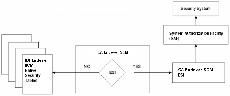

The Interface for External Security
In addition to native security, CA Endevor SCM provides the CA Endevor SCM Interface for External Security (CA Endevor SCM ESI). With CA Endevor SCM ESI, installations which currently use CA ACF2, CA Top Secret, or RACF security systems can secure access to CA Endevor SCM functions and data sets through those centralized systems rather than locally through CA Endevor SCM security tables. CA Endevor SCM ESI accomplishes this through an interface to IBM's System Authorization Facility (SAF). As illustrated in the following diagram, CA Endevor SCM ESI replaces standard CA Endevor SCM security tables with an SAF interface module:
This figure illustrates how ESI replaces standard CA SCM for Mainframe security.
With CA Endevor SCM ESI in place, each security request is checked through the centralized security system in order to validate access to CA Endevor SCM environments, menu options, and actions against inventory elements.
