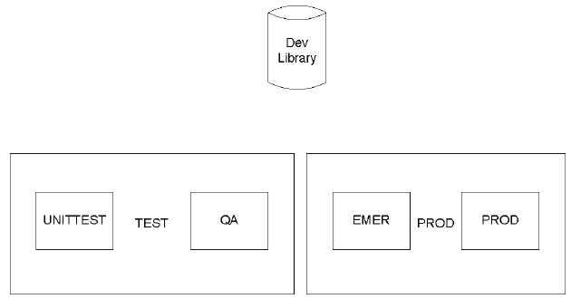

Environment is the CA Endevor SCM term for functional areas in your organization. In this example, assume that the UNITTEST and QA stages in the lifecycle are part of the development function, and that production applications and their maintenance are part of a function called production. The administrator defines environment TEST to include Stages UNITTEST and QA, and a second environment called PROD, that includes Stages EMER and PROD. Development activities take place in a development library, outside of CA Endevor SCM. This is illustrated by the following diagram:

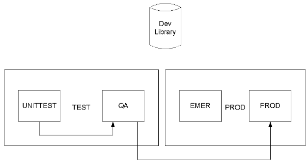

The CA Endevor SCM administrator might decide to establish the following route (environment map) for inventory at this site that promotes inventory from Stage UNITTEST to Stage QA to Stage PROD, as illustrated in the following diagram:

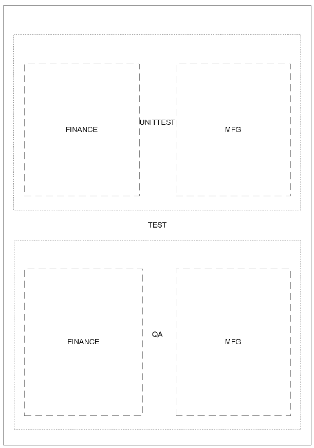

Define the Systems
You must define a system to each environment in which you plan to use it. There are two systems in this example: FINANCE and MFG (manufacturing). This is illustrated by the following diagram:

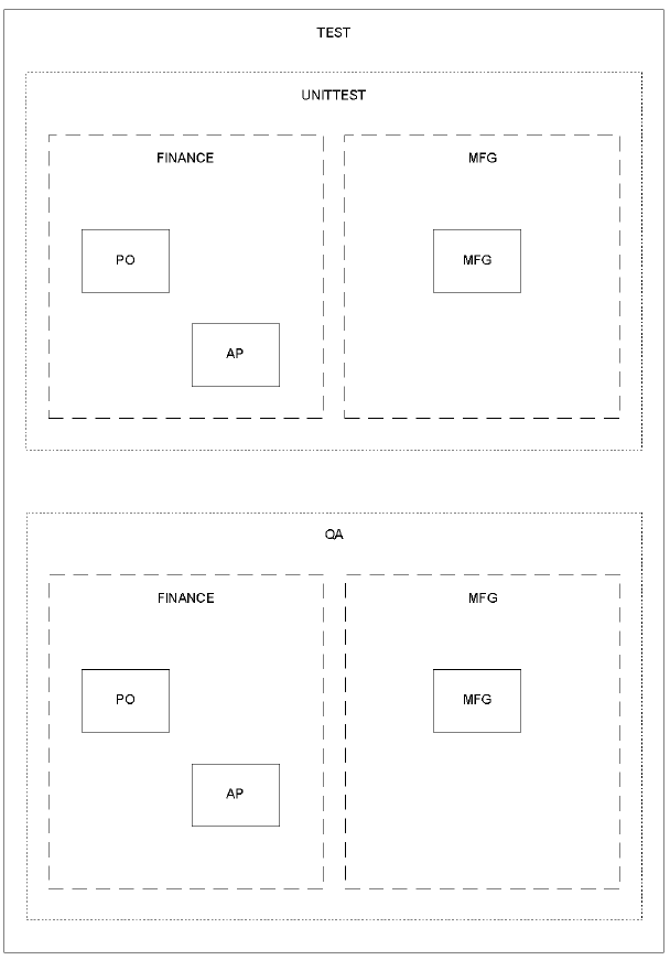

Define the Subsystems
You must define at least one subsystem for each system. In this example, system FINANCE has two subsystems: PO and AP. System MFG one subsystem, MFG. This is illustrated by the following diagram:

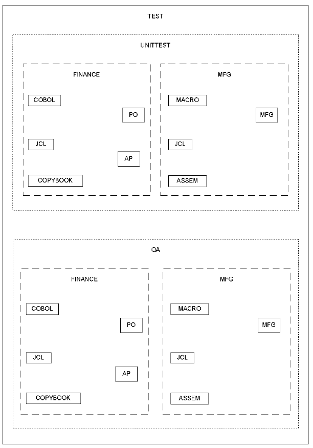

Define the Types
You must define types to each system/stage combination in which you plan to use them. All subsystems defined to a system can use the types defined to that system. You must define types at each stage in an environment. In this example, system FINANCE has available the types, COBOL (COBOL code), JCL (JCL streams), and COPYBOOK (copybooks). System MFG has available the types, ASSEM (Assembler code), JCL, and MACRO (Macros). This is illustrated by the following diagram:

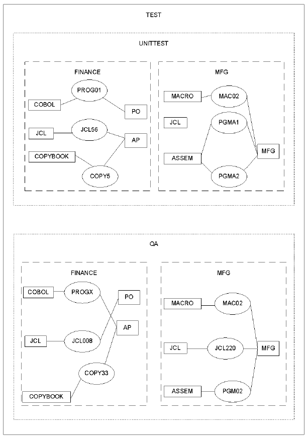

CA Endevor SCM classifies elements according to the inventory structure you set up. Each element is described uniquely in terms of its:
This figure illustrates how elements are classified based on the inventory structure the CA SCM for Mainframe administrator defines.
For example, in the previous diagram, elements are classified as follows:
