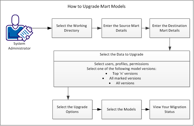

The following diagram illustrates how you upgrade models:
Complete the following tasks to upgrade Mart models:
