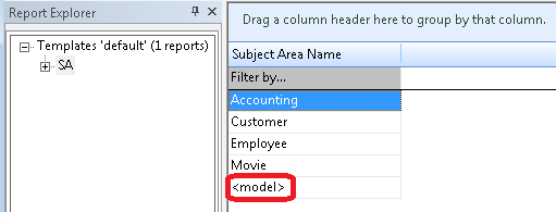

By design, a model is considered as the main Subject Area. Therefore, when you create a generic report on Subject Area and include its properties such as Name, the model is also displayed in the list of Subject Areas. However, the model name is not included when you generate a report on specific Subject Areas. You can generate a report on specific Subject Areas by selecting the Specify Diagrams at Run Time option.
The following diagram shows a generic report of Subject Area:
In the previous report, <model> is the model and the remaining entries are Subject Areas.

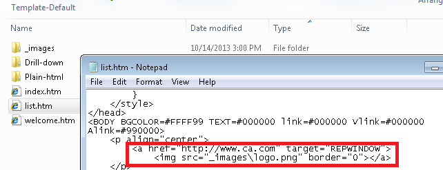

By default, CA logo is displayed on HTML reports and the logo is linked to the CA website. You can change the logo and link it to a website of your choice.
Follow these steps:
The logo and the link to the website are changed when you generate a report the next time.
