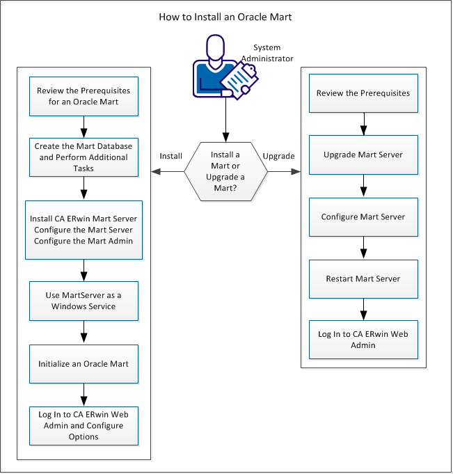

Illustrating the process of creating and configuring an Oracle Mart
Complete the following steps in the same order to install and configure the Mart:
  1. Review the prerequisites of an Oracle Mart.
  2. Create the Mart Database and perform the additional tasks.
  3. Install CA ERwin Mart Server.
  4. Use MartServer as a Windows Service.
  5. Initialize an Oracle Mart.
  6. Log in to CA ERwin Mart Administrator and configure settings.
Complete the following steps to upgrade a Mart from r9.0 to r9.1:
  1. Review the Prerequisites
  2. Upgrade the Mart Server
  3. Configure the Mart Server
  4. Restart the Mart Server
  5. Log In to CA ERwin Web Admin
