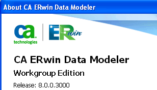

Effective with r8, the release of this product is displayed in the About CA ERwin Data Modeler dialog using the following release numbering scheme:
About CA ERwin Data Modeler dialog release numbering scheme example
The first number always indicates the main (GA) release, the second number indicates the service pack number of the main release, the third number indicates the patch number of the main release or service pack (or both), and the fourth number indicates the build number of the product. For example, the preceding illustration indicates that the product level is r8, Build 3000. A release of 8.1.2.1500 in this dialog would indicate r8 Service Pack 1, Patch Release 2, Build 1500.
