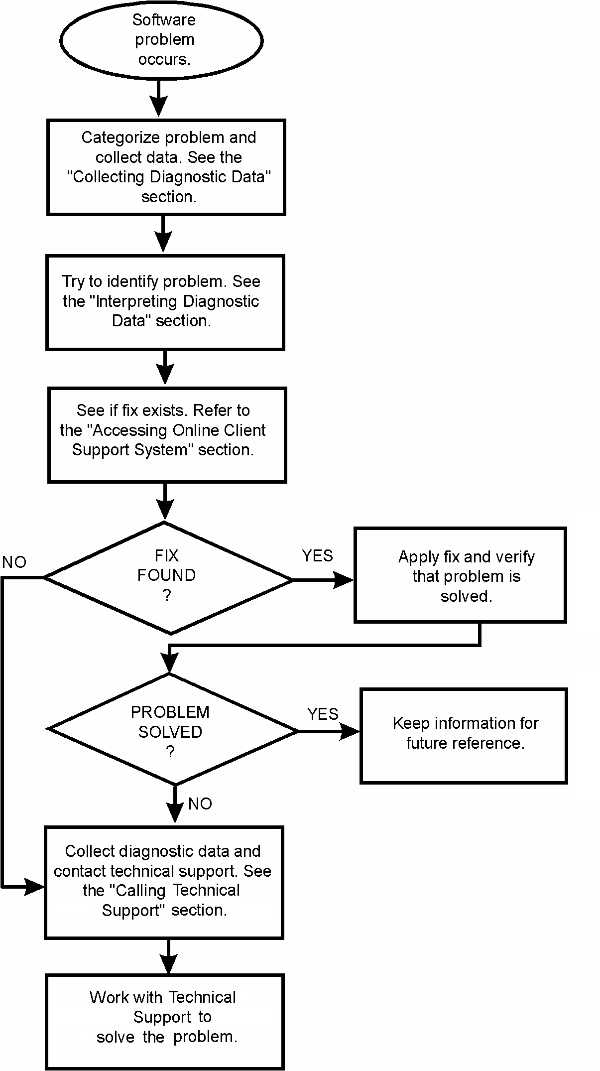

Refer to the following flowchart for a summary of the procedures you must follow if you have a problem with a CA software product. Each of these procedures is detailed on the following pages.

From your response to these questions and the diagnostic data, try to identify the cause and resolve the problem.
