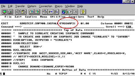

This template, once customized to conform to site standards, demonstrates how to create implicit IXUPDATE commands. The default for @JOB (OPTION, OUTPUTDD) is SIMULATE, so when you are ready for the real run, simply change SIMULATE to INTRDR.
The following illustration is the sample FMSSAMP3 from the INSTALL library.

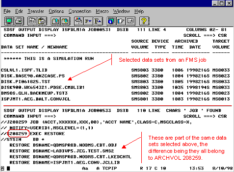

After this is complete, executing FMSGEN will result in output similar to the following:
