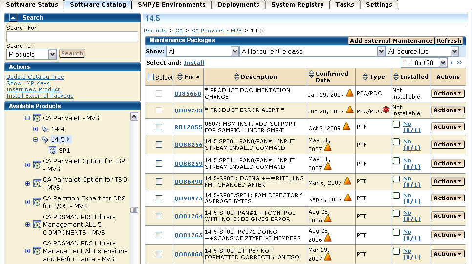

  3. If the information indicates that maintenance is available, click the Release Name link.
    The maintenance packages are listed, for example:
    The screen capture shows the Maintenance Packages section for a product release.
    Red asterisks identify HIPER maintenance packages.
  4. Click the Fix # link for each maintenance package you want to install.
