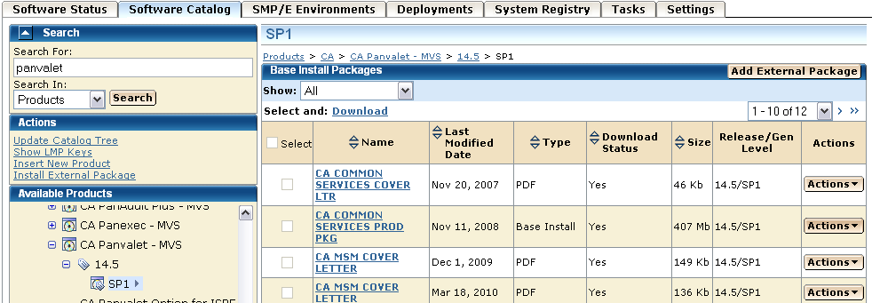

  1. Click the Software Catalog tab, and select the product gen level (for example, SP0 or 0110) you want to install on the product tree at the left.
    Information about the product appears in the Base Install Packages section at the right, for example:
    The screen capture shows the Base Install Packages section for a product gen level.
