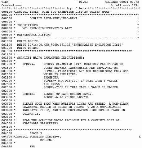

The volume serial exclusion table is initialized to empty. Patterns are not permitted. The following illustration is a sample of the ADSOPVOL source:
Disk_Install_ENU_151
Note: The LENGTH parameter within the ADSOPVOL source must be left untouched. This is the maximum length for each volume serial, and is set at 6.

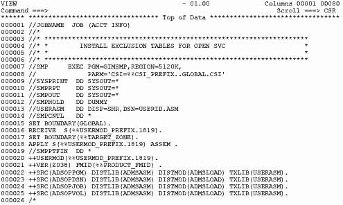

After your exclusion lists have been defined, an assembly process can be applied with SMP/E in the form of a usermod. Installation library member USERMODM provides an example of this process.
The following is a sample of USERMODM:
